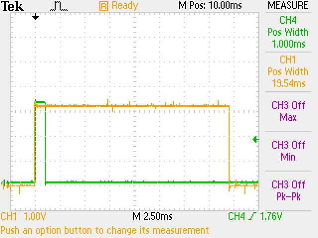

    int on_time_t = 36864 ; //(1 msec => (1000 usec * etpu_a_tcr1_freq) / 1000000;
    union etpu_events_array my_event_array[2] =
    		{(0x00000   << 1) + FS_ETPU_PIN_HIGH},   // pin goes hi
    		{(on_time_t << 1) + FS_ETPU_PIN_LOW}	 // len lo after on_time_t
    while ( 1 )
    	J2[7] = 1; // Use J2[7] to trigger scope. QOM Pulse on J2[9] should follow it.

Re: 5234 eTPU code for QOM module?
fanat thanks... This looks more and more like an issue with the 2.5.3 release... I've tried your code on two dev 100's w/ two 5234 modules w/o success. I can run other eTPU code like the PWM module on the target pins, but not the QOM module. Thanks again for your help. I have an open ticket w/ the support guys.
fanat9: Thanks for the .s19. Your .S19 works on my board demonstrating that the hardware/scope setup is OK.
As a next step, I rebuilt your source on 2.5.3, using the unmodified C:\nburn\MOD5234\system\ETPU\ETPUinit.cpp. It did NOT work.
