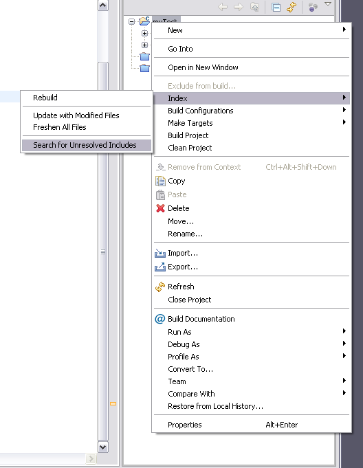

Anyway, you can always manually set whatever it can't find. To see unresolved includes go to "Project/Index/Search for unresolved includes". In my case it was:

Check for unresolved includes.

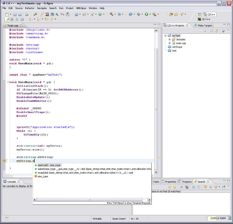

Code assist suggestion for std::string

Thanks again. Adding the "lib" path seemed to do the trick for me. Much nicer now.
