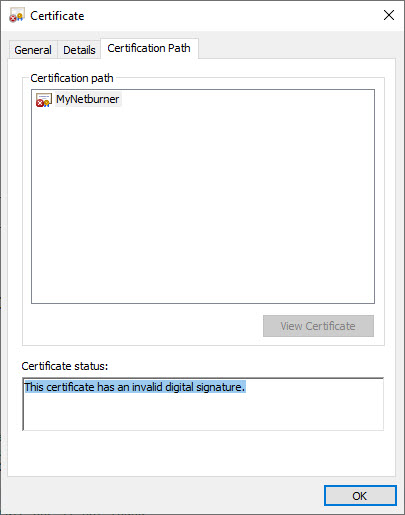

using 3.5.0 and NANO module.
I am doing SSH R&D, and I started with example SSH/sshServerUserAuth. It build and runs fine.
In the example it call to generate a cert and key if there isn't one available for use. So I add a dummy html and enable HTTPS web server in the project. the certificate I download from the web browser indicate the certificate that generated has an invalid digital signature.
then I build the example, SSL/SslOnboardCertGeneration/Simple without any modification. It's the same result.

with further troubleshoot, I found that was caused by the signature algorithm mismatch with the public key algorithm in the certificate.
Since it's a self signed certificate, the two algorithms in the cert need to be the same, either RSA or ECC.
If a cert was signed by a CA, the signature algorithm in the cert need to match with the CA encryption algorithm.
The fix I make to SSL_CreateNewSelfSignedCert(CertGenData & GenData) in \nburn\libraries\crypto\NetBurner\NbCertGen.cpp
#if defined(SSL_KEY_ECC)
    gNewCert->sigType = CTC_SHA256wECDSA;
#elif defined(SSL_KEY_RSA)
    gNewCert->sigType = CTC_SHA256wRSA;
#endif
