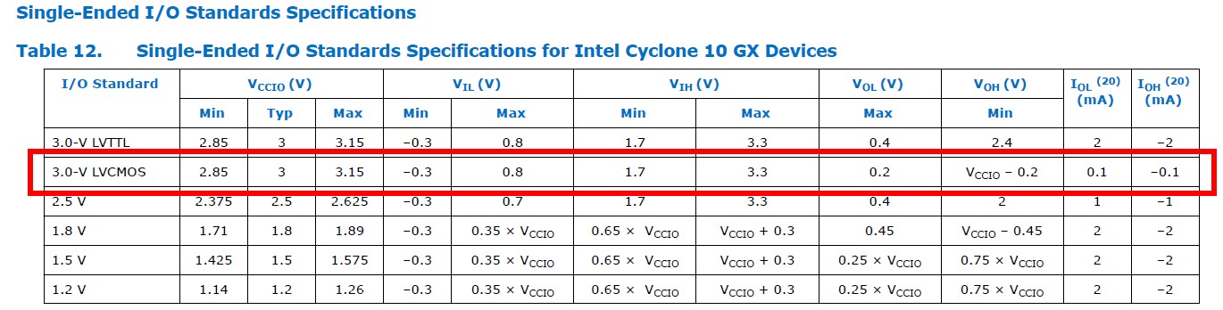

https://www.intel.com/content/dam/www/p ... /an447.pdf
looks like 3.0V LVCMOS has guaranteed high of 2.8
well above the requirements.

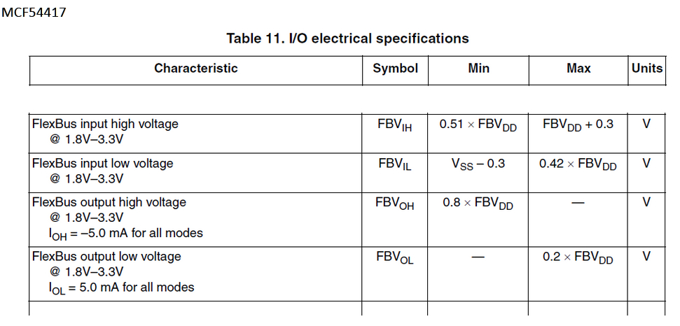

Seems like it should work. I take it 0.65 Vcc = 2.145 confirms Vcc = 2.145 / 0.65 = 3.3 V for the flex bus voltage.
But the MCF54417 data sheet seems to have different numbers. It has Vin high min = 0.51 * VDD instead of 0.65 * VDD. The 0.51 and 0.42 for the Vin high min and Vin low max and did seem awfully close.
Just using the numbers in the datasheets:
10% tolerances could be a problem, especially on the first one but in principle I guess it will work.
Netburner Cyclone C10GX
Vout low max = 0.66 Vin low max = 0.8 ok
Vout high min = 2.64 Vin high min = 1.7 ok
Vin high min = 1.68 Vout high min = 2.8 ok
Vin low max = 1.4 Vout low max = 0.2

I guess my png attachment did not take.
- cyclone10GX_IO.jpg (111.03 KiB) Viewed 9743 times
