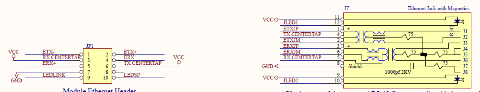

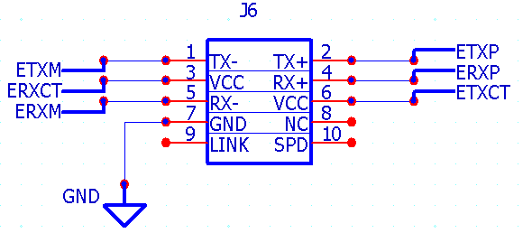

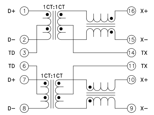

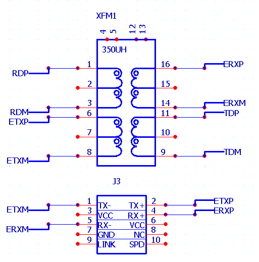

My first question is about hooking up VCC. Is this schematic saying that VCC comes from J3 on pins 3 and 6 and should simply be connected to the CT of the magnetics, or is it saying I should add additional feeds to the NB thru J3 and also feed it into the magnetics CT? My second question is in the depiction. This is from the spec sheet for the Halo product:

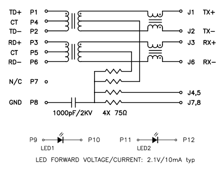

I'm asking this because I want to make sure I use my magnetics properly. The app note seems to suggest that the configuration of the transformers on the RX and TX side are 'inverted', if you will, while the spec on the Halo suggests that the oriention of the transformer pairs stays the same on both the RX and the TX side. Do you understand what I mean? If you call them Vertical or Horizontal, the Halo product shows VH, VH for both the TX and RX, The App note shows VH on the TX side, HV on the RX side. Which is correct?
For magnetics, I choose a Wurth Elec product, #749020100, which has the exact same attenuation per frequency band as the Halo product. But it shows this internal schematic:
It clearly doesn't have the internal resistors the Halo products shows, or the connection to the capacitor. But by the same token, I'm using the 4 pin M12 shown in the next picture. Phoenix Contact 1411975. How should I terminate the CTs of the cable end? I don't have a J4,5, etc. Do I need to add the resistors and capacitor?

This is the current schematic, not knowing exactly which was I should connect the magnetics:

Re: MOD54415 / M12 Ethernet Conn
The center taps on the cable side, are probably ok to leave off....
Teh centertaps on the netBurner side do need to be connected.
The inversion should not matter as all modern PHY's have built in correction for this ...
And the VCC is sourced by the netburner you do not connect VCC there... (In fact on some boards the CT is not VCC and the "Vcc" pin does not go to VCC.) It depends on the Ethernet PHY.

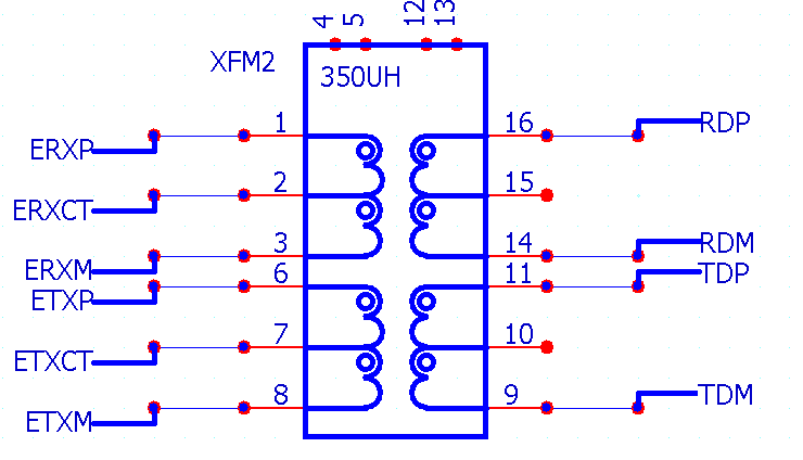

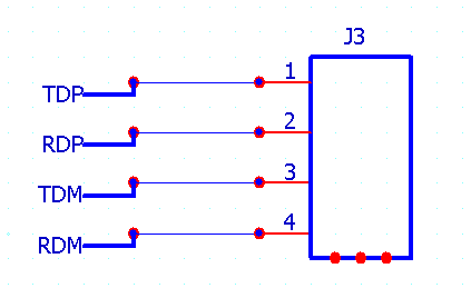

Just in case anyone's following along, this totally works! I had the schematic wrong for M12-Ethernet. 1-3 is TX+/-, 2-4 is RX+/-. I used these parts:
1 - Magnetics - Abracon LLC # ALAN-101-T (Digikey 535-13501-1-ND)
2 - M12-4 D Conn - NorComp Inc # 861-D04-213R004 (Digikey NOR1818-ND)

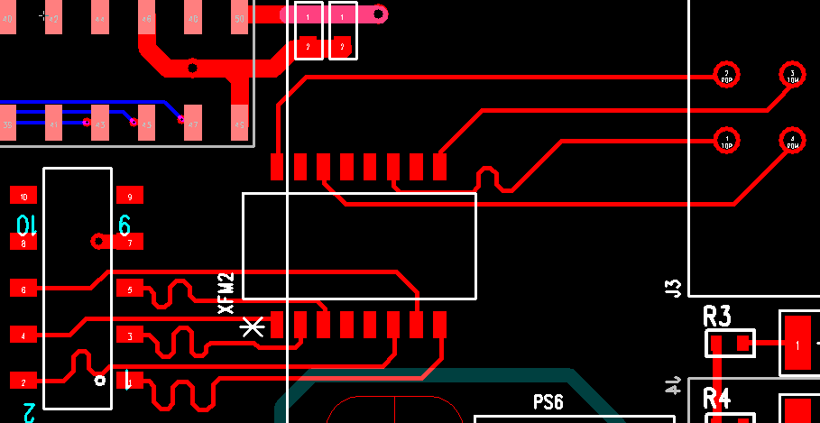

Some schematic / layout snips
The NetBurner Connector
The Magnetics hookup
The M12 Connector
The relevant layout area

Don't know why the pictures came out wrong, but I think you get the idea. - Dan
