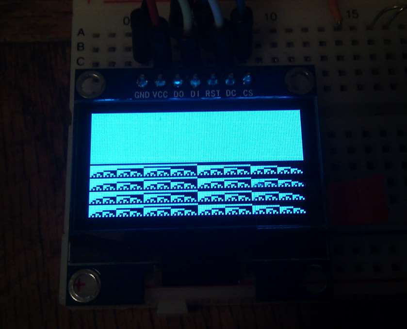

I bought a small OLED display on ebay, thought I'd share the source code in case anyone else finds a use for one of these. I have the 1.3" screen with the SH1106 controller on a breakout board that has SPI headers. It has a resolution of 128x64 pixels.
http://www.ebay.com/itm/281648238188?_t ... 2749.l2649
The controller can also do I2C and a couple other connections, but I went with SPI for faster updates. As it turns out, SPI provides plenty of bandwidth. With a SPI clock speed of 32 MHz, I can rewrite the entire screen ~930 times per second. I'm not sure if the LED pixels update that fast or not, would need a high speed camera to test. It looks smooth though.
There are libraries out there for this controller for the Arduino, so between reading through those and reading the datasheet, I came up with code to use this display with the Netburner.
A couple notes:
1) There is no data to read from the controller, so there is no MISO line. It does use three SPI lines (CLK, MOSI, and CS) plus two additional GPIO, one to reset the display, and one to specify if the data coming into the display is commands or display data.
2) The controller supports a resolution of 132x64, but the display is only 128x64. The displayed data is centered in the array, so if you set the command bits to flip the screen horizontally or vertically, the image will still be complete.
3) Writing data to the screen requires you to send a command byte to specify where you want to write the data, then you can write data to the location, up to the end of the line.
