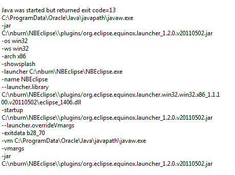

I installed NNDK 2.73 on a new windows 7 laptop and when I start NBeclipse it says Java not found and aborts. Any ideas why it was not installed with the new install or what I need to get and from where to fix this?

Attached is the error window...
JAVE Error.jpg (77.09 KiB) Viewed 12224 times
Re: Installed NNDK 2.73 on a windows 7 pro laptop and wont r
Number one cause of NBEclipse launch failures: NBEclipse requires the 32-bit version of Java to run. Try that.

Ok NetBurner support says it is the Java 64-bit, did that solved the problem?, if so how do I get java 32-bit, somehow java.com keeps detecting my 64-bit OS, not allowing me to manually download the 32-bit.
