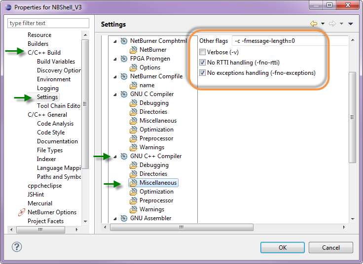

The resolution to the problem strikes me as somewhat strange. Eclipse does not (to the best of my knowledge) automatically turn on Exception handling. In fact, for this project under the project Properties->C/C++ Build->Settings->Gnu C++ Compiler-> Miscellaneous settings (see image) I have the checkbox enabled for No exceptions handling (-fno-exceptions).
