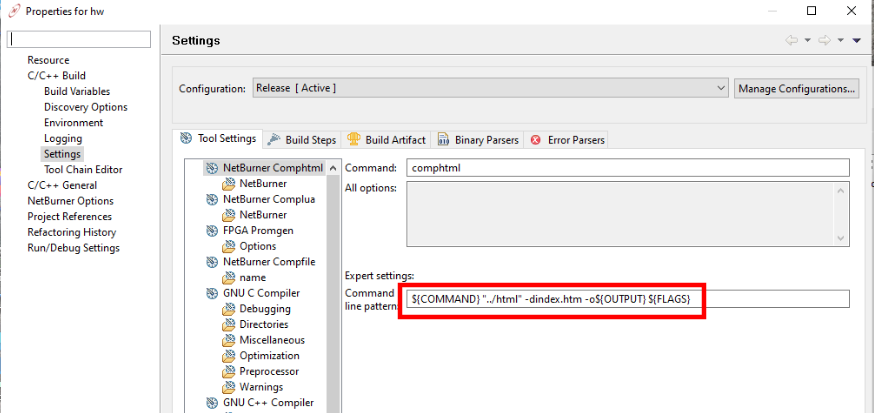

Posts: 288
Re: Web with SSL enabled
You can modify the comphtml flags directly. See screenshot Add the flag "-dindex.htm" if you want the default file to be index.htm instead of index.html
