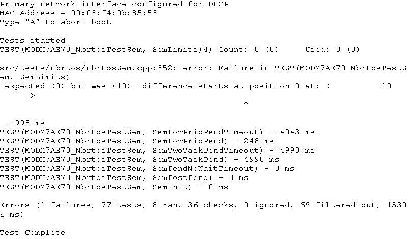

Just checked out the new unitTest example in NNDK 3.2, and it seems to have an issue on the MODM7AE70:
Is this a potential bug, or more likely to be due to pilot error?
Unit test failure on MODM7AE70

Hi KE5FX,
Thank you for bringing this to our attention. That particular test is actually invalid and should have been removed from our testing suite before the release. We apologize for the confusion and will make sure it's taken out for the next release. Please don't hesitate to let us know if you have any questions about the tests themselves or run into any other issues.
